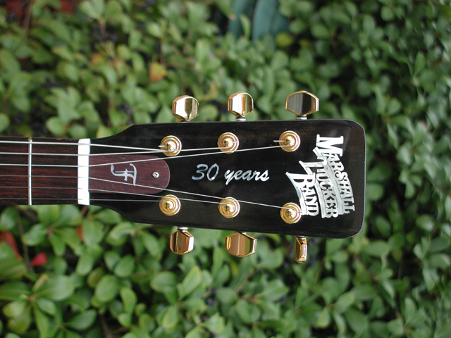

When my wife does 0's she cuts out the center and then cuts a tiny piece of ebony to fill in the hole. Here is an example of her work. All the letters and the zero are filled with tiny pieces of ebony.

Wow Dave your wife does some great work. I love that headstock.

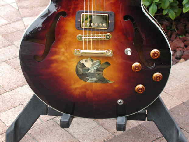

Here's the body inlay. The guitar is a 335 style electric.

Wow, Thats very nice inlay work!
